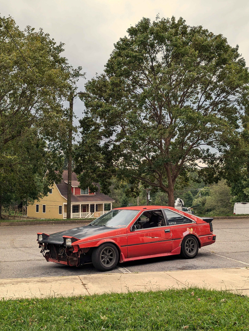

Current state of car. Watanabe all around looks so good. Bumpers off bc of hurricane (flooded roads ripped all but 2 zipties and I ended up dragging it a couple miles home during record downpours lol).

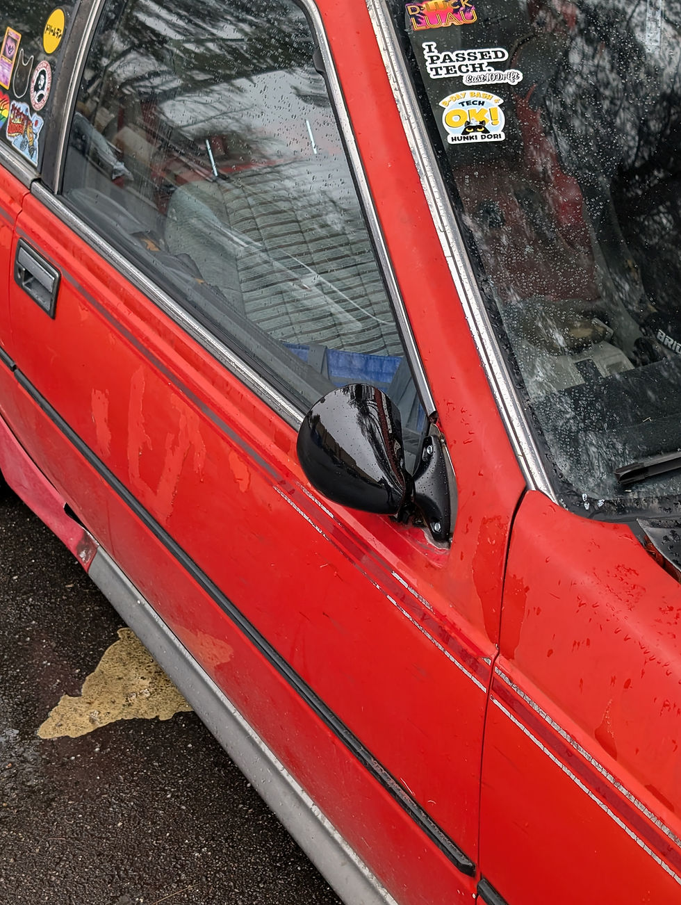

Current mirror situation, got a plan for a set of aftermarket mirrors to fit as soon as I get the cheese. Its funny and actually more functional than expected.
