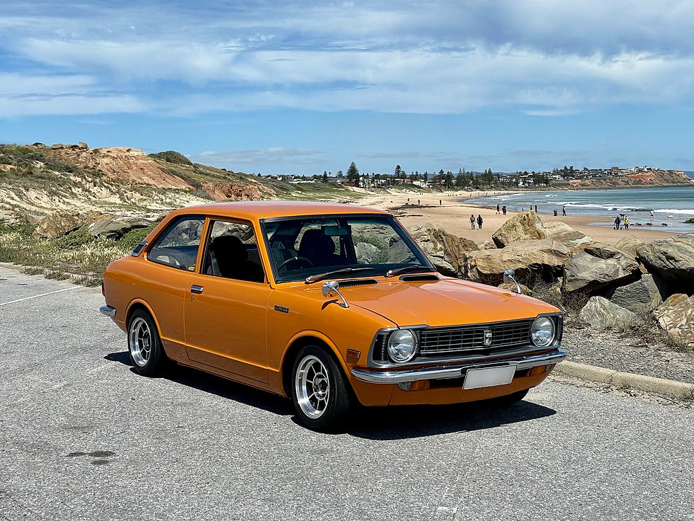

Picked up some drip rail trims when getting the panels. They break up the orange a little, this car never came with higher spec trims it was a base L model that doesn’t even have a cigarette lighter or radio.
Paint work was starting to look beat at this point so started prepping the body again then got lazy and it sat in the garage almost 3 years half prepped. Finally got some motivation mid this year to finish it off .
As usual high quality spray booth.
Added factory fender mirrors and and ordered a pair of 7j's to match the rear wheels as i was never much of a fan of the staggered sizing.
And that was how it was going to stay a weekend cruiser, i drove it around for a couple months until a shitty driver fucked up at a give way and fucked my shit up so now we wait for insurance to do their thing so i can get fixed back up again.
