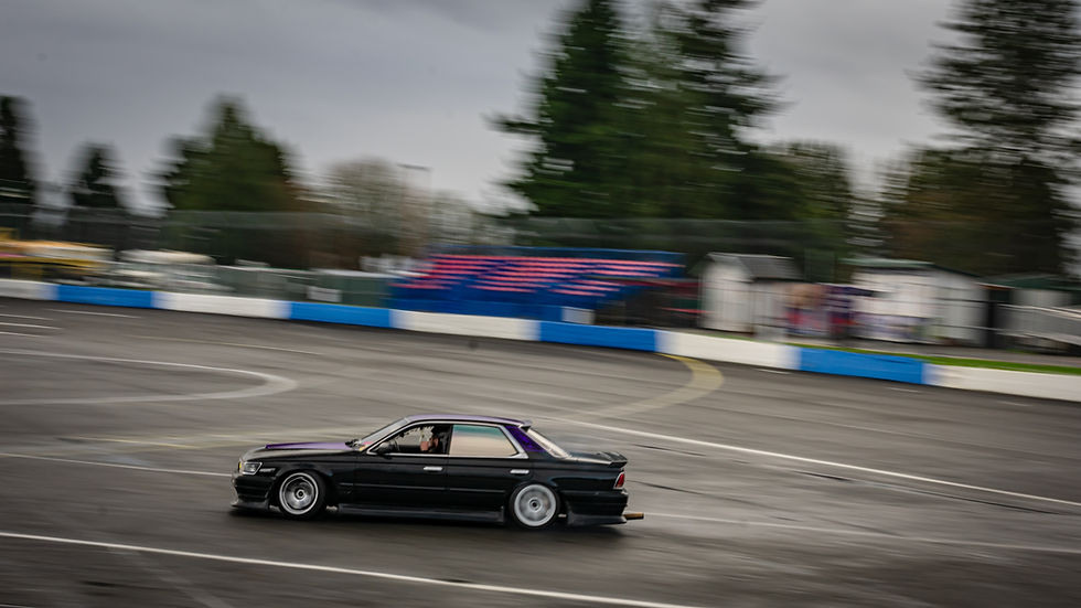

Backstory I guess? Bought this car in Saitama while I was stationed in Japan for $2300 in 2016 as a pretty standard spec rb20det manual swapped car, teins, shotgun exhaust, bride zeta, and nismo short shifter. Been through a few iterations aesthetically as well as rb20, standard rb25, and now forged and top mount rb25. I'll throw in some pics over the years as well as it's current look and specs. Thanks for looking!
1989 Nissan Laurel

This thing is TOUGH! Love it! 😎
i miss all you guys, hope to see you all drive next year
2016-2018 spec
Rb20det
2019-2021 spec
