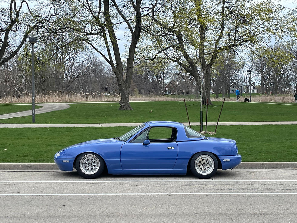

pic of car from this year's "first drive"
Exciting to see a Miata with that like, classic early 90s flare without dipping into dorky territory. I adore this thing
