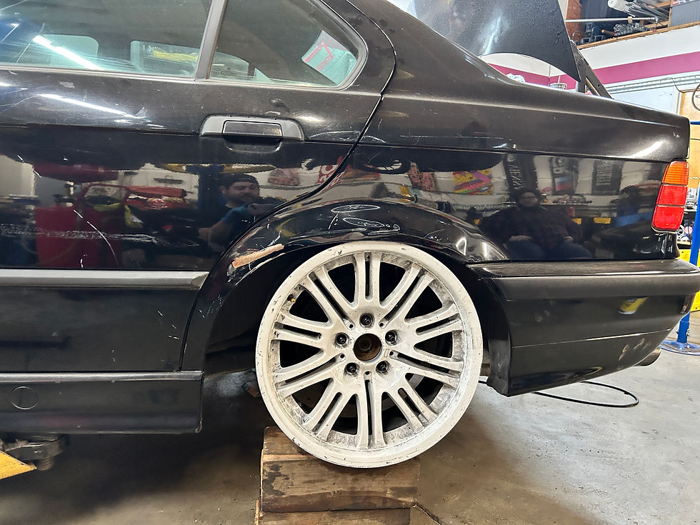

First push out of the shop with new suspension and of course some late night wheel mockups.
