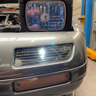

Sourced some wise square Parker lenses that really update the look of the front end.
No provision for a parker light globe tho so I’ll have to fabricate a bracket as Aussie cops will have a meltdown if they don’t light up.
