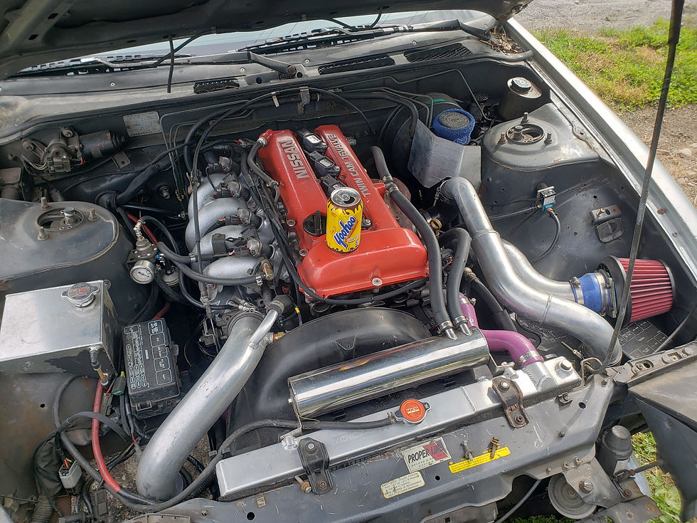

Semi-current engine bay shot, it sports the PO's valve cover paint to this day. It has since received a cleaning, tidying of odds/ends, and a Tomei N2 oil block feeding a Grex oil filter relocation feeding a Koyorad oil cooler. Along w a Future Fab manifold, and a new Garrett GT2860RS. I love this engine so much.

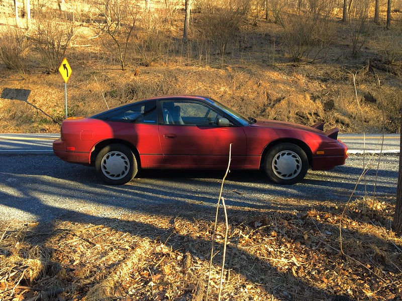

Next up is my 1992 cherry red hatch. I'll try to keep this one quick. Got in 2018 for $850 from an auto auction I worked at in college. Bone ass stock, no rust, cold AC, manual. Reliable as a top. I'm actually dailying this against my will as I type this, through a Pennsylvania winter. My daily (2000 Civic EK hatch which I also adore) has run into unexpected chassis writing-off rust. Picked up another shell to hopefully get together and get the 1992 off the road for the winter. Luckily PA hasn't salted the roads yet...
This car will likely get one of my oem kouki bumpers, my oem kouki skirts and tails, with super modest coilovers and monoblock 17's, and be incredibly stock otherwise. Backburner for now though, it's great as the time capsule it currently is.
