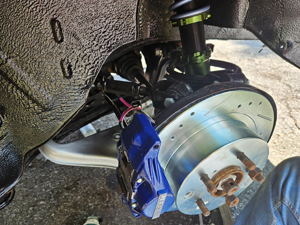

The latest focus has been getting everything under the car (suspension, brakes, angle) finished so I can move onto aero/bodywork, interior, and engine. Latest goal has been a comprehensive, quality Z32 brake setup. I mentioned earlier that I don't like the look of hydros or dual caliper, so I managed to put together a fully functional Z32 setup using primarily GK tech parts, with their N-style conversion lines, and most importantly, Project Mu D1-spec shoes!
This is the LH rear coated. Coilover reinstalled and began assembling the Z32 drum hardware.
Rear is complete, and I can tell that the cable ebrake will work well. The GK-tech cables and cable adapter plate are nice pieces. They fixed the driveshaft clearance issue w the plate that I've heard about - when I reinstalled the driveshaft where was plenty of clearance. 5 stars on all of the GK-tech stuff I have on this car so far.

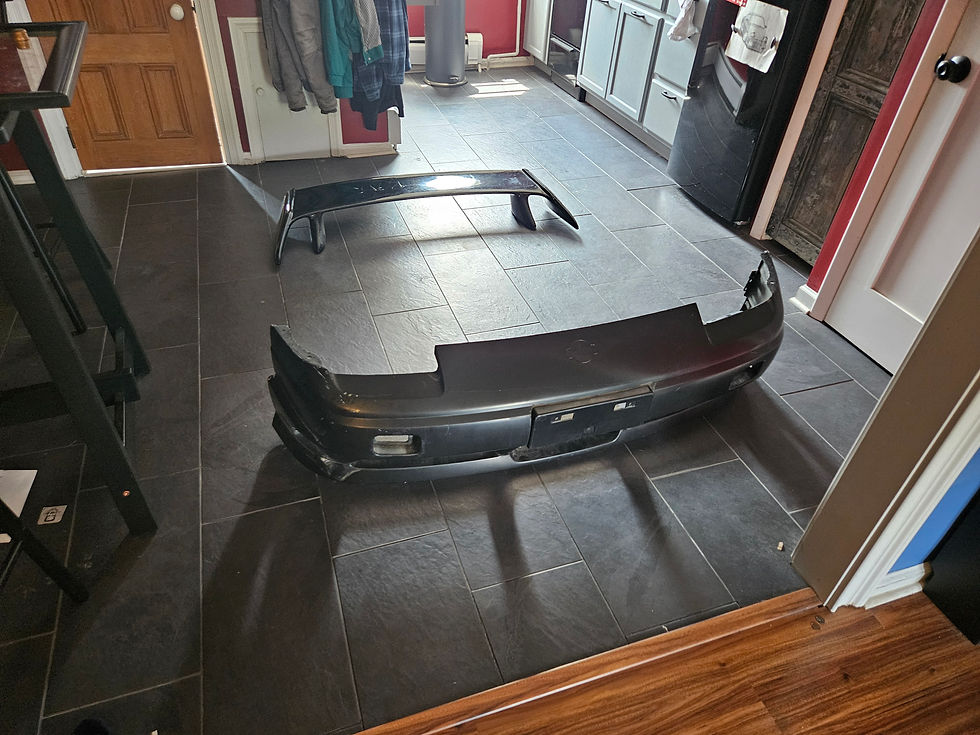

Managed to snag a trade for an old wing I had for a GT-1 Break Itoh wing. A very fun come-up for a part I was dreading having to import.
