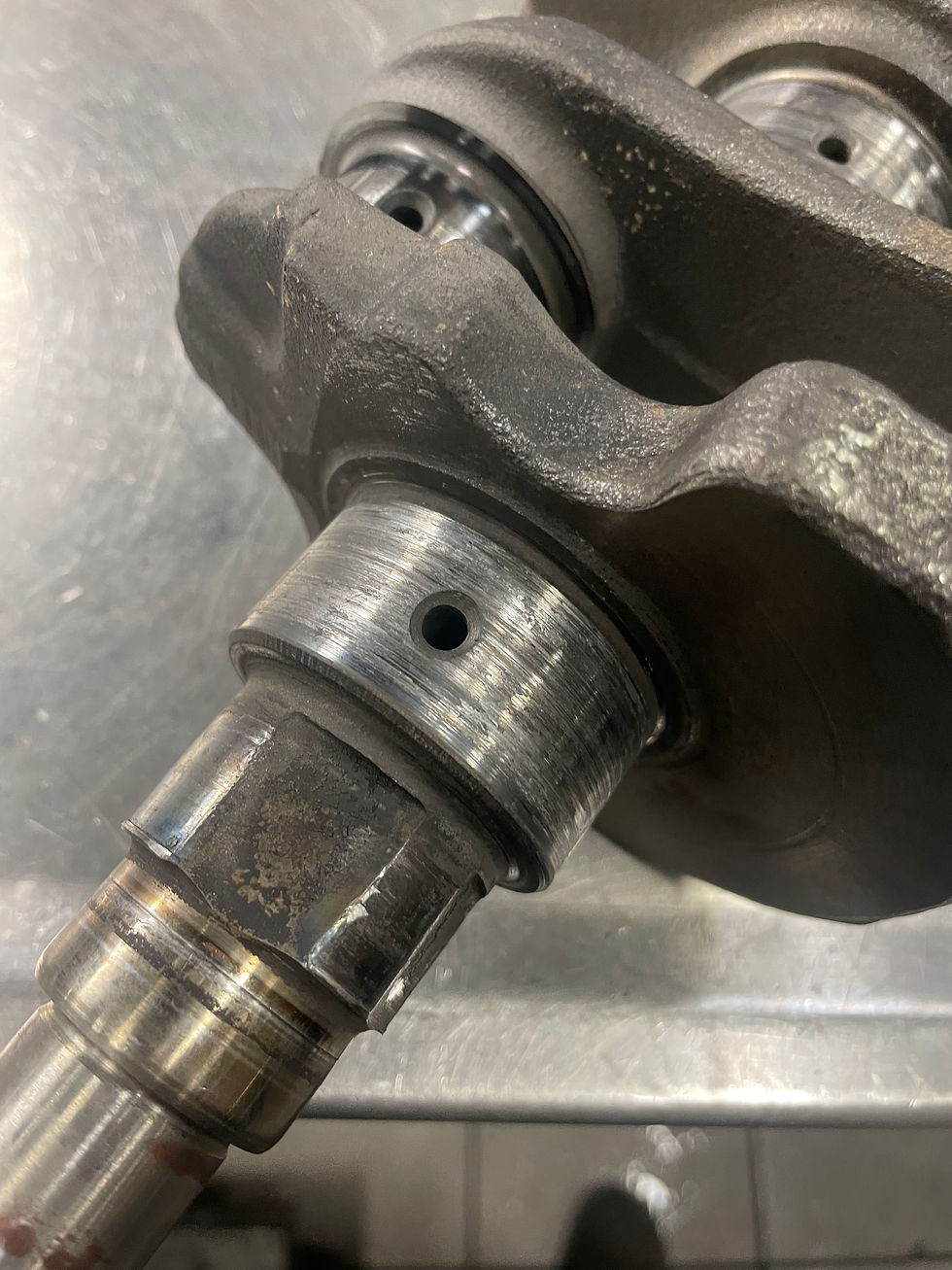

Little update. Took that spare engine apart. Top end looks good, cylinders look good enough. Nothing a ball hone can’t fix. The crank on the other hand is pretty smoked. Not sure if it’s saveable or not. I feel like my best bet is to either take it to a machine shop to see what they think, or find a used 40mm crank. I could easily get a 42mm crank, but then I’d need rods and pistons, which is a rabbit hole I don’t feel like going down for an engine I don’t need currently. Into the corner of the garage the engine goes haha

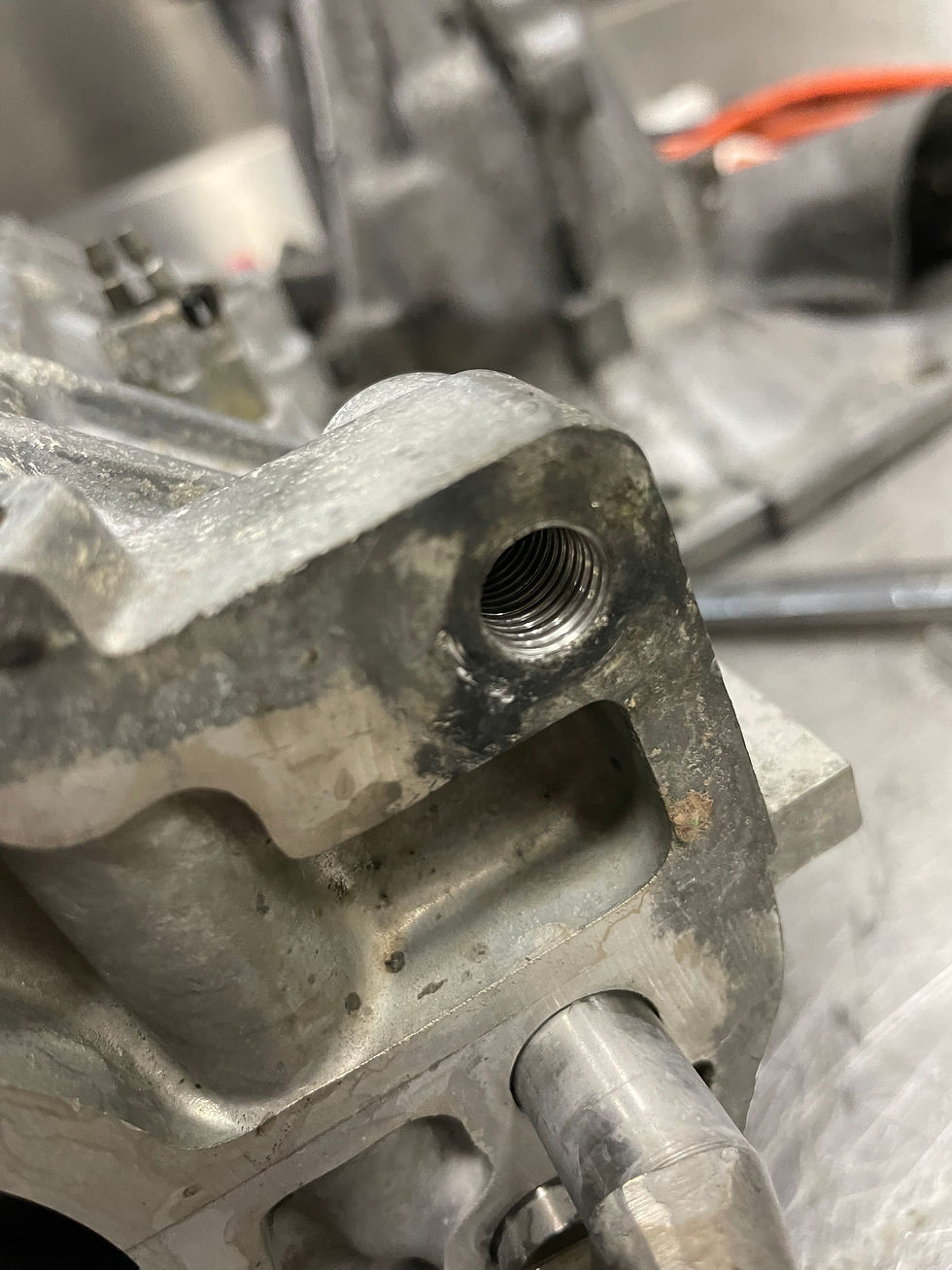

Good enough for me. Next was to remove a snapped tail housing bolt. This thing was in there and took some persuasion to get out
Still need to run a tap through, but it's out. Next I took everything home and reassembled on my favorite dryer/workbench. There's no seals or fluid in yet, I just wanted to check all of the shift forks and make sure the trans goes into all of the gears, which it does so I'm pretty happy about that. I put a different tail shaft housing on with a different shift rod. Seemed to do the trick. I'll probably update this with photos of the other transmissions and engine when I get around to those

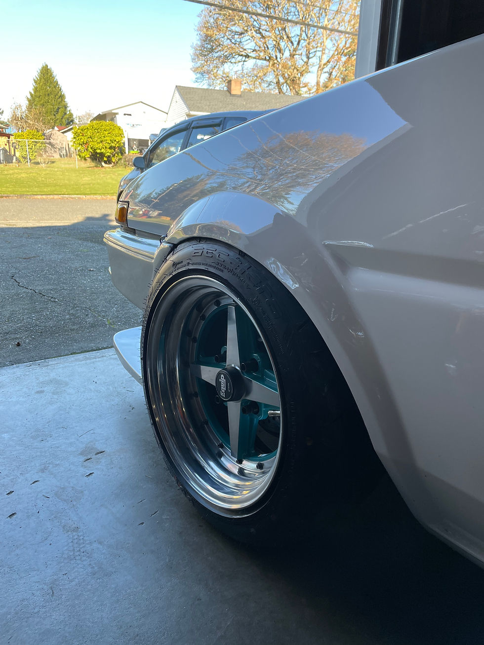

I think the next part is I ended up buying a set of equip 01's. I've always liked these wheels and I'm happy to have a set. The window of the spokes on the front pair are painted teal, but they'll get painted black over the winter. I think I had the wheels for 6 months before getting flares to fit the rear wheels. Over the last couple of weekends I messed around with mounting tires and installing the flares. I also installed the ganadors on the car. I think the fit the car pretty well. I still need to do some tinkering with them and paint them body color, but I'm super into it.
