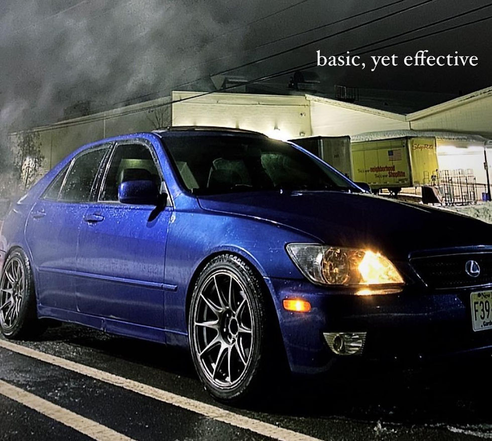

Bought a set of cheap wheels because again, they were local and $150. You see the trend here:
I drove it in this form for a while. Just going where I need to go, maybe switching the wheels for winter but life was good. Even acquired a set of wheels I always liked: 17x9 5Zigen FN-01
I started to find out that the car actually felt pretty good to kick around! Sure it would only lock up on left turns but mind you, I have not drifted in a few years at this point and was probably foaming at the mouth with the thought of: hey, I can do this again. So............
