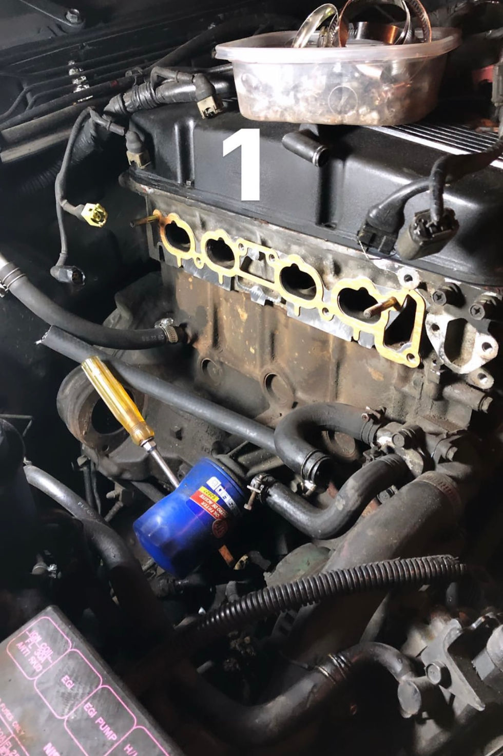

So continuing on, that event I mentioned I noticed I had oil pressure issues. I had a pbm gauge that monitored oil pressure, water temp, voltage. I ran like 5w40 rotella in the car which was plenty heavy for what I was doing with the car. I was seeing oil pressure get down to 6-7 psi at idle. So, when I got it back in the garage I hooked up an oil pressure gauge and verified it against my gauge and it was true. I figured it wouldn’t hurt to do the timing chains and a oil pump.
unlike the dohc, the single cam uses an external oil pump driven off the distributor. So when I pulled the timing cover I noticed a guide had a couple inches missing off it
Installed a Martin industries ratcheting tensioner, new timing chain. All new oem rocker arms as well because it had some valvetrain noise. At this point this was more or less a experiment. I honestly should have let it be and conk out when it inevitably happened. I ended up pulling the engine and obviously finding the pickup tube full of old guide material. Tore the motor down and found some scoring on some of the bearings. I had two dohc ka's lying around and a s13 sr20 that needed a rebuild so I just opted to put another ka in it.

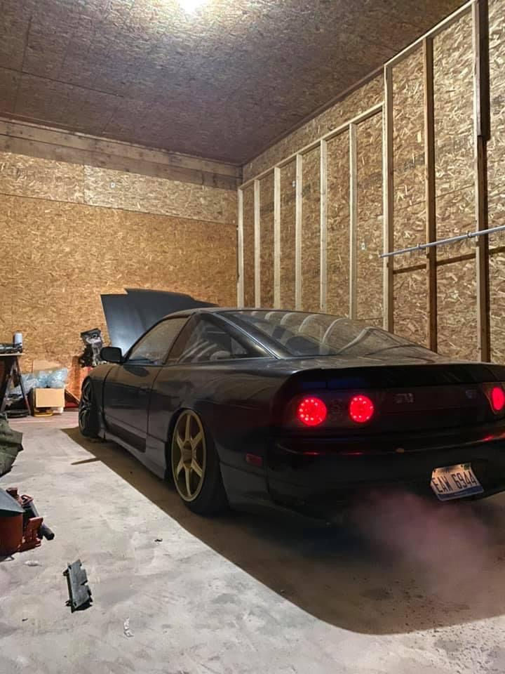

I had some old paint that matched the car so I decided while the motor was out to give it a quick spray along with stitch welding some parts of the bay. These are definitely some things that I will come back and address again when the car is sprayed eventually. But for now, it will do. I did prime the bay and stuff I just couldn't find the pic nor did I feel the need to show you guys something you've seen a million times I'm sure

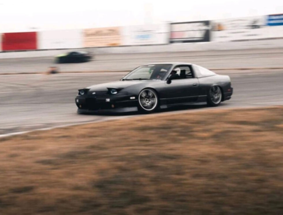

Updating again though I should be asleep. So, like I said, I ditched the sides+rear and pretty much got rid of my 18s. Got rid of the hurricanes which ended up on teddys black 180sx from garage abstract. I had signed up for an event at Kilkare raceway hosted by drift Indy. It was a two day event and the first event I drove this car at. It wasn't my first event, just in this particular car. It was still single cam at this time aswell but pretty well sorted it seemed. Didn't get many flics on track this was around 2019.

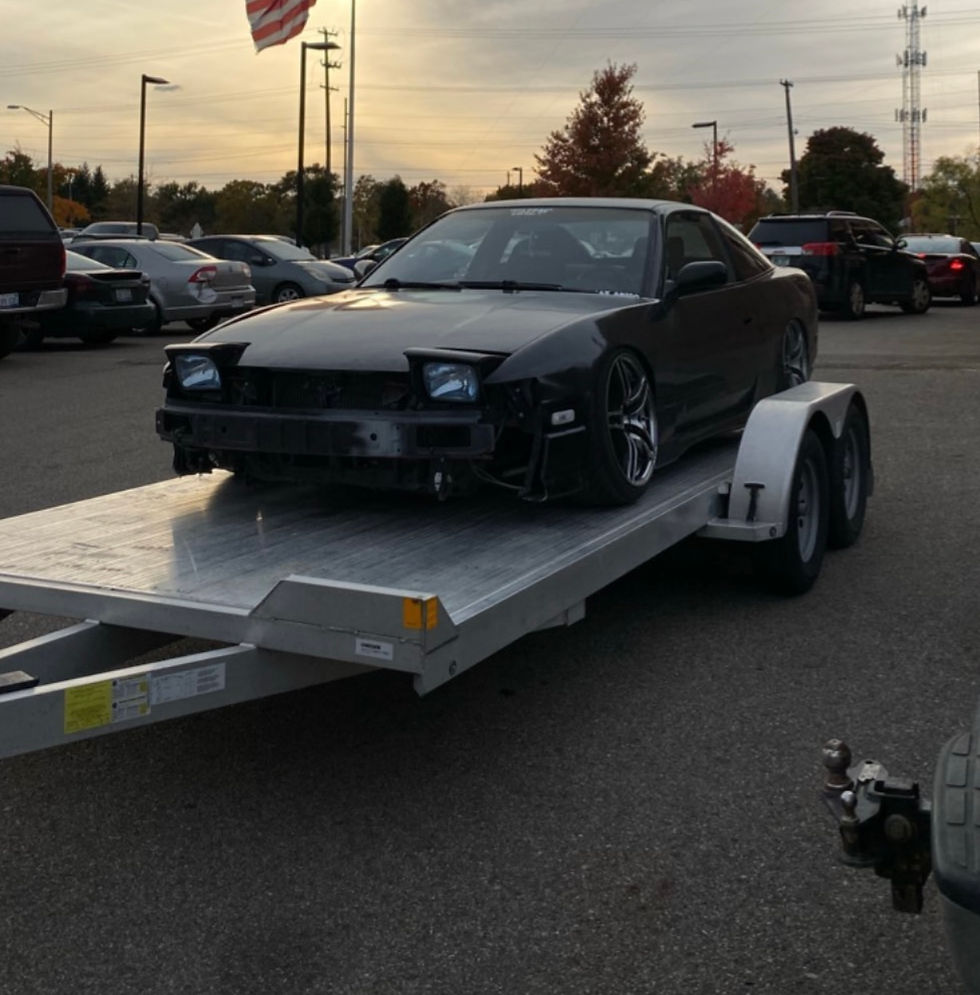

Pulled my bumper off to make sure it didn't get wrecked loading up on my buddies trailer
The single cam performed flawlessly despite dealing with oil pressure issues I was noticing on the track. It never ran weird or had any weird noises but I suspected something internally was wrong after double checking hot oil pressure with a mechanical gauge vs my pbm gauge I had at the time.
