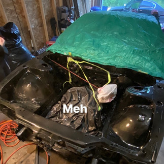

I had some old paint that matched the car so I decided while the motor was out to give it a quick spray along with stitch welding some parts of the bay. These are definitely some things that I will come back and address again when the car is sprayed eventually. But for now, it will do. I did prime the bay and stuff I just couldn't find the pic nor did I feel the need to show you guys something you've seen a million times I'm sure
