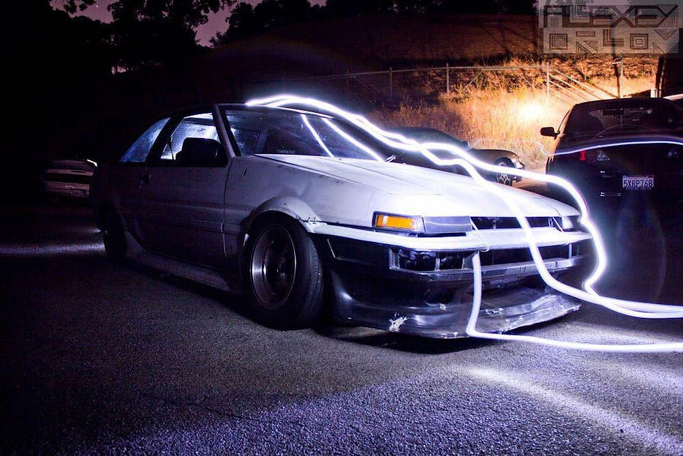

Hello! This is Lola, my 1984 toyota corolla gts that I’ve had since… 2007. It’s gone through quite a few phases but I’ll always intend to keep it as a “street” driftable car with a toyota A-series powerplant… or as a pretty lawn ornament!
Current setup:

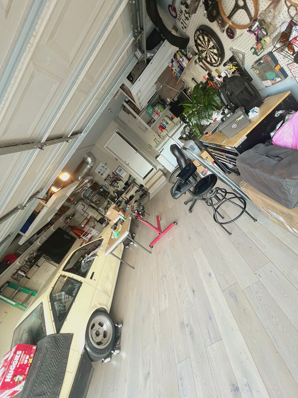

So the motor popped at the GLL ae86 day event. I got some decent runs in, but what got me was probably combination of back to back runs, lack of oil cooling (no cool down lapping allowed), spotty alternator or battery (kept stalling out at idle). What happened was when i was pulling in from a run, the car started stalling out, then it did stall out for a moment. Even saw oil pressure drop on my gauge. I brought it back to life with tapping on throttle, and then the ticks started coming. First they were faint and sporadic. Then after another run it was a bit louder and more noticeable and consistent… So I stopped for the day and drained the oil. And voila, liquid glitter.
With the engine out, I did some more researching to figuring out possible causes of noise, like piston slap, things to do when oil pressure is lost, etc.
I also took the opportunity to get a different engine block to start fresh with a proper bore to supertech’s specs (0.003” piston to wall gap, prior block was like 0.005ish. A bit out of spec for supertech’s likings). No squirters, so all oil pressure goes to lubing absolute necessities (bearings lol).
Then also adding an accusump to the system. And an oil cooler.
And this is where I’m at today. Block is fresh from machine shop. Crank got resized/polished to clear the wear stuff, acl race bearings that fit the undersided crank. And pretty much everything else to get it back together.
Hopefully not too long because I have another kid on the way, and that probably means… a realistic time frame for me back to running status will be 2025 lmao.
