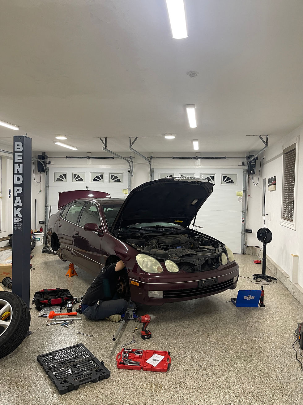

I bought another car! It had sat “for a while” (later learned it sat for 10 years) and smoked but otherwise ran fine, had a welded and BCs, and was a factory manual 1993 SC300. I test drove it, manjied the main road in the rain, and decided it felt strong and got myself all excited to drive. The rain was super heavy and it was an hour away so I decided to drive it home the next day. Pictured here is where it broke down a mile from where I started.
The Lexus was fighting us and with the newly launched 3 day Staggered motorsports festival looming, I borrowed a friend’s 350Z to drift because I can’t miss any fun or I’ll explode. Tossed my wheels and seat in (didn’t fit in his) and it was ready. Fun fact, 215 fronts and 225 rears are not enough tire for a Z. Still, welded diff, hydro, and the GK Tech catalogue for the front makes for an Assetto car in real life. So easy to drive it was almost boring. Also having AC in the D car is addicting.
(Side note: peep my dad’s Navigator I put Gram Lights on because I have no self control)
The event also had time attack which I competed in with my EK.
So the long of the short of it, the Lexus was costing more money that I was prepared to spend and we couldn’t figure out what was wrong without really diving into it so I put it up on marketplace to cut my losses. It ran but it smoked terribly, which we thought might be an internal issue which I was not prepared to deal with. This is deep into the sad era of cars for me. I broke the EK at another event, my other project was hemmed up, the 240 was a decoration, and the SC wasn’t going to pan out. I was offered a trade which I decided to take purely out of curiosity and a means to an end. That night the new owner took the SC home where it locked up immediately (he was cool with that, I felt horrible) and a new ray of sunlight shined on me. Enter the best car ever made:

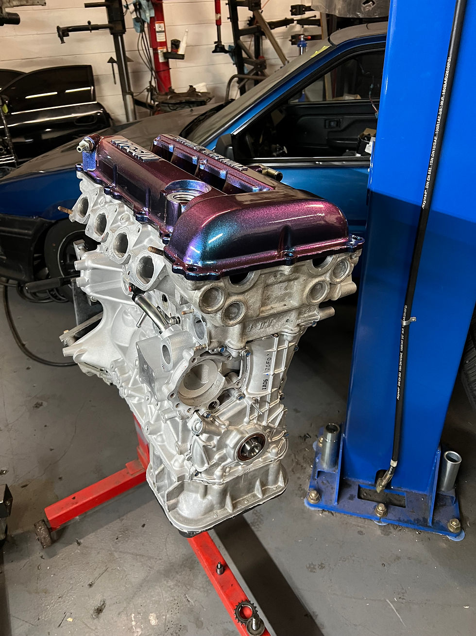

This winter the SR build was finally done at the machine shop. I don’t have a pic, but the head and block are now mated and ready to be dropped in (hopefully this month).
The build is:
S13 SR20
Manley rods
CP pistons
Tomei poncams
Dual valve guide conversion
BC valves and springs
Tomei head gasket
King bearings
Mazworx timing kit and chain tensioner
S15 oil pump
JUN oil pan baffle
R35 smart coils
Sard 550CC injectors
Garrett GTX2863R
Engine management will be a Haltech Elite 1500
The goal is a responsive 300hp. It’ll be overbuilt for it, but I wanted to make wanting more power in the future easy if I became unsatisfied.

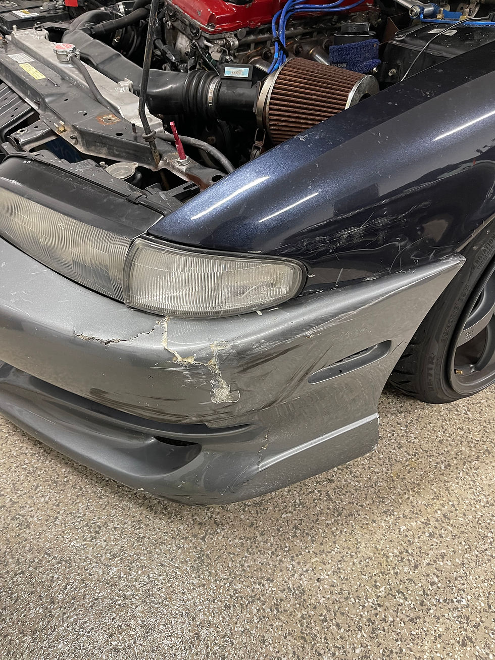

My front bumper was thrown from the car regularly.

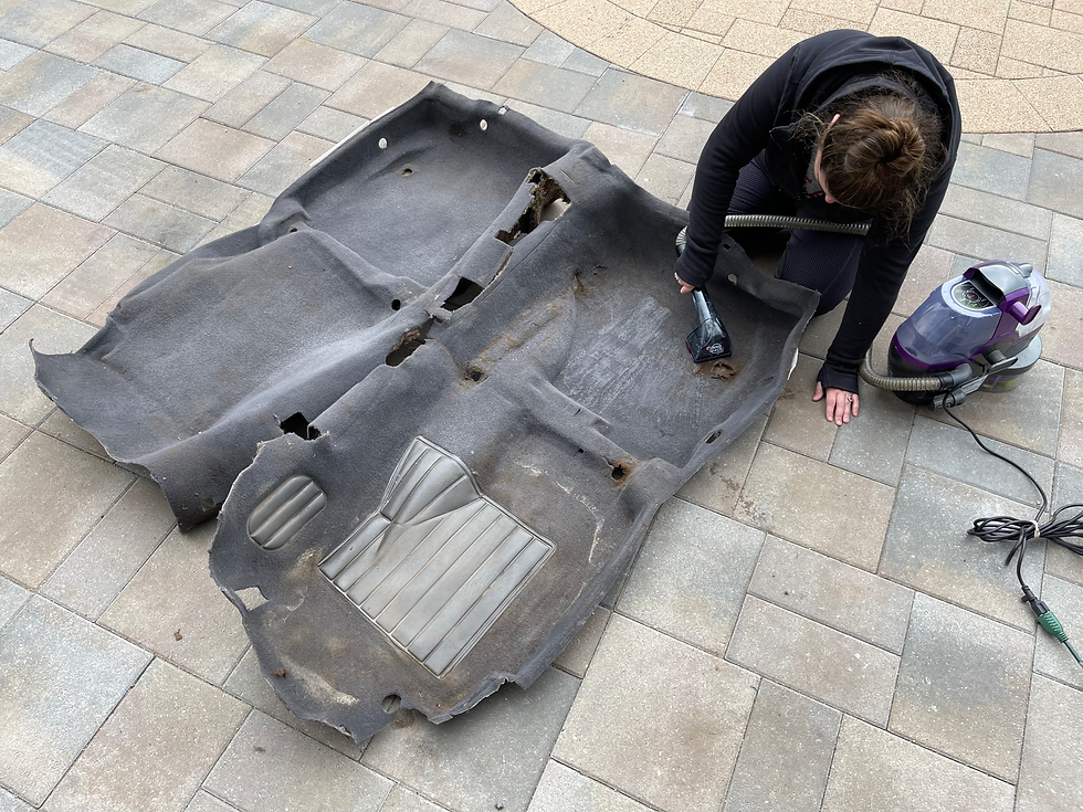

My sister loves detailing so she blessed my carpet. It's still kinda clapped so a replacement might be in it's future.
