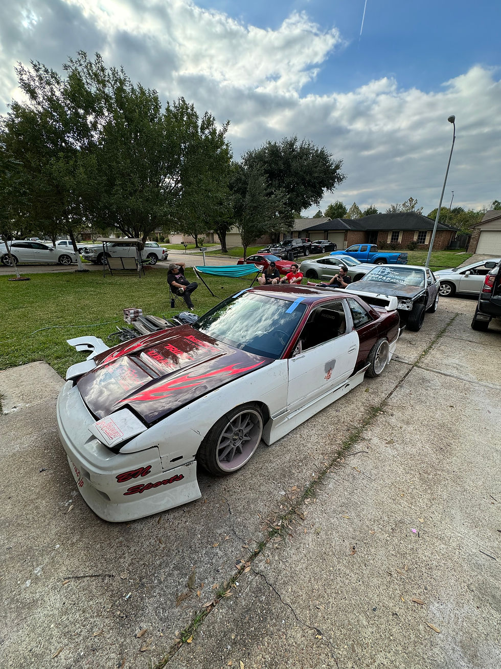

We can start it off with the previous car, here is the last version of my white coupe. For FB south I wasnt too motivted to drive (large events arent really my thing, i prefer smaller events) so I slapped whatever non-broken aero I had. I was always curious if Msports would flow with URAS, imo, with a bit of effort it can.
Unforunately luck wasnt on my side nor was common sense and I had a boop with my teammate Aaron. This shell was honestly a bit beat already and the boop was kinda the last ding for it to be retired. This shell went thru many different phases and I enjoyed them all. Lots of long lasting memories made in it that are important to me.

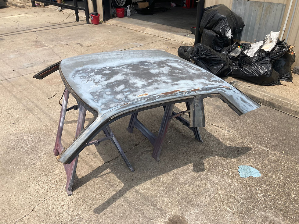

Then the roof swap process started... I had no clue what i was doing and i learned how to mig weld just to complete this. If I can do it, anyone can do it.

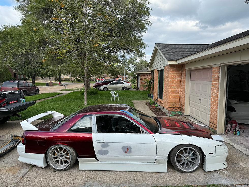

Now, this is where things go HORRIBLY WRONG. Its been two days and im noticing that the clear isnt drying, im having an internal panic attack and the world is crashing around me. Seems like the company sent me a bad batch of hardener, and with my lack of experience i had no idea. The only proper solution was to strip the car down to bare metal and start again which i did. The disapointing part was that Javi helped me paint the car so now his hardwork was for nothing. This second time ill be on my own painting a car for the first time. I regret not painting the jambs again first but it was a learning experience and I will probably be painting the car again later in 2024. With candy you need to paint the car with the panels on but i dont have the space nor compressor for that, so we will with the results lol
This is where things get interesting, I wasnt quite happy with the silvia parts I had so I decided to put the silvia look on hold till I have the parts I want. I was able to get lucky and get a rep Bstyle 180 kit, as well as a red carbon msports hood again.
