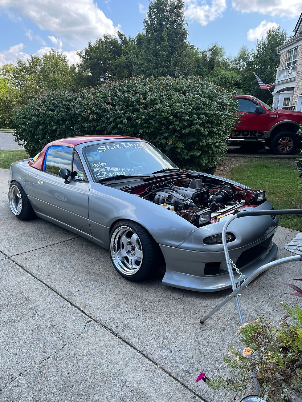

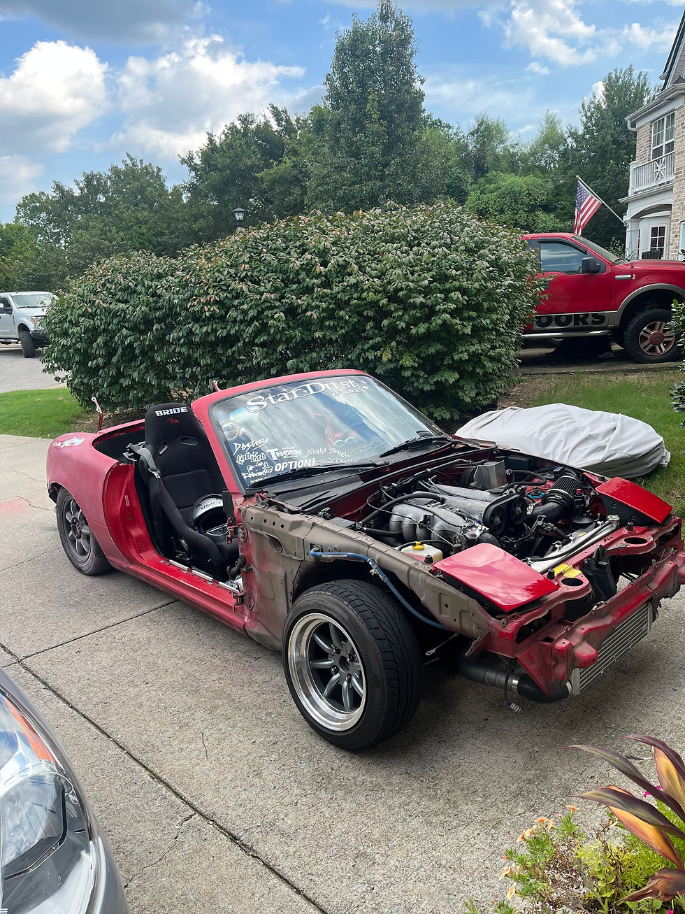

Got to taking the rest of the panels off of the car and bringing them to the shop. Got in there and started prepping them, I didnt really worry about all the small dings and what not because I wanted to get it done fast and I also knew it would stress me out if I had a perfectly straight car by the end of this. It turned out really good for the most part though.
Was really happy with the progress but it took longer than I had expected due to schedules not lining up and what not. At this point it wasn't even halfway done and it had been a month so I really wanted to do all I could. I took the parts I had and put them in storage and whenever I had time after work until sundown I would work on prepping the car. I had bought some supplies and an electric da just to do this.
Started off masking the interior off after the doors and top were off. Ended up kinda redoing the bottom because I covered the door jambs up lol.
Started one night on the jambs. This sucked just hitting it for so long by hand with a scotch brite pad.
Then on an off day I woke up and tackled the rest of the chassis. Quarters, rockers, a-pillars, trunk jamb and above the windshield.
This is how it was after a lot of work, then on the weekend I threw some taillights back in and drove it to the shop like this to get started.
Was ridiculous but fun to drive this again after over a month of not driving it ;(

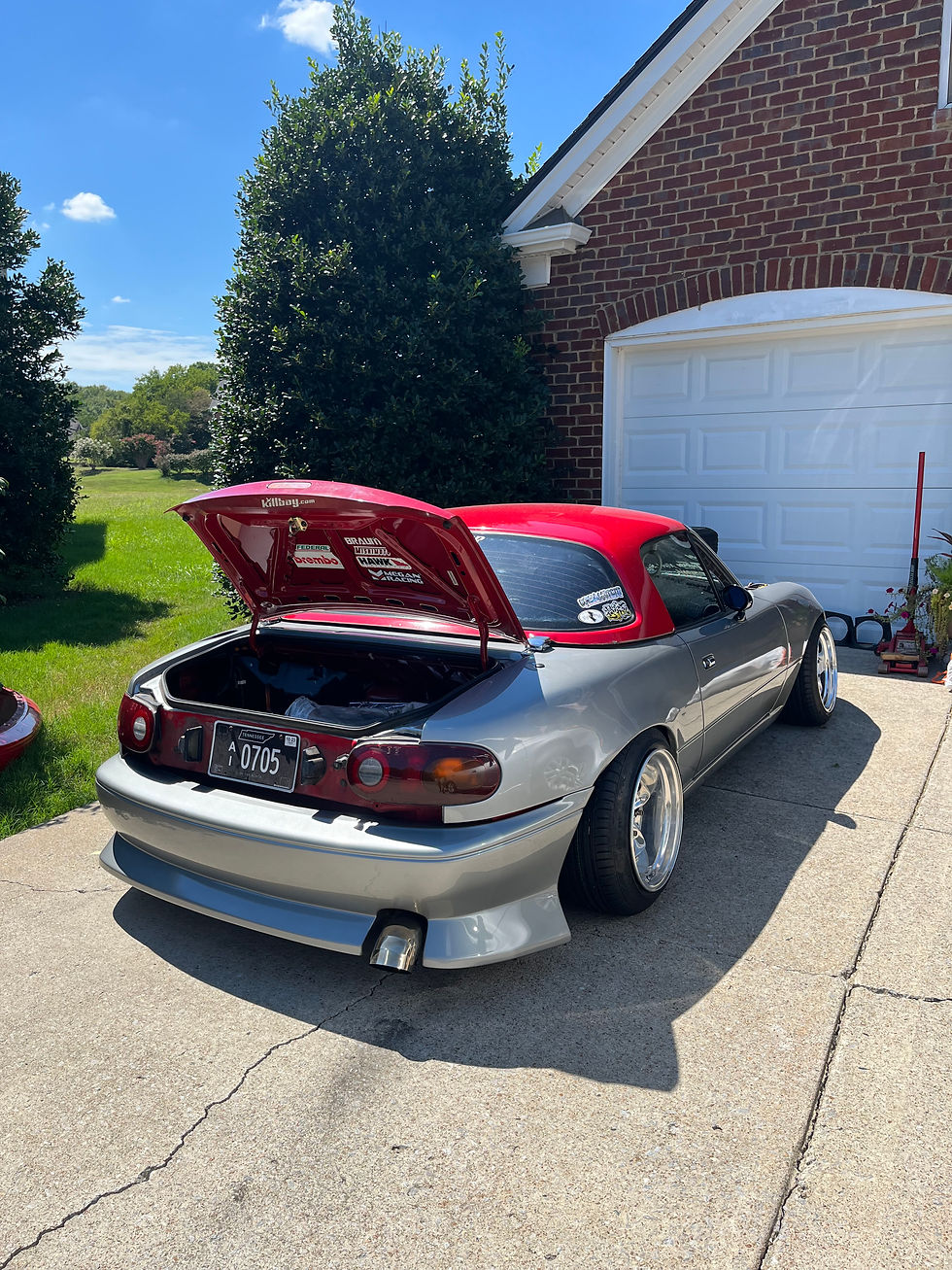

Pulled the car into the booth, masked it off and gave it one last wipe down before applying sealer to it. This was the biggest part of the project and was a surreal moment for me.
Sealer down
Then base
Then finally clear!
The next day I went to go pick up the car from the shop after the clear dried. Got a little excited after I got home. Was so relieved that the biggest piece to this project was done.
Brought the doors and my old trunk home to put them on. Right before I went to sleep I found out it was going to pour the next day while at work so this wasn't a fun night trying to tackle this myself.
Eventually brought home the bumpers to put on. Slowly it was getting there.
During all of this I picked up a straighter trunk lid than the one I had that was hail damaged. Once I dug into it though I found a lot of uneven body filler so I got rid of all that. In the background was a straighter hood I picked up probably two years before this and it was rattlecanned badly and had a few problem areas. After trying again and again to fix it, I realized I'm not a body guy and didn't have the patience to get it straight. This just gave me an excuse to buy a vented fiberglass hood (which I wanted anyways) but I left the trunk lid to my buddy to fix.
He did a great job, got that put on along with my trunk spoiler and was loving it.
Decided to go with m2 1028 rep mirrors since I couldn't seem to get my hands on bomex mirrors for so long. Also got jass performance low profile headlights because I didn't wanna pay 1k plus for rs actives.
The skirts were actually the second pieces to get painted all that time ago. I had initially bought some starlight metal flake from tropical glitz and wanted to just have a dusting of it in the paint. We forgot about it when we painted the rear bumper, but I thought if we did it on the skirts and I liked it we would redo the bumper and do the rest of the car with it. I had another buddy at the shop and they both kept wanting to add more flake to it while I was sitting there sweating. He sprayed it and it came out as this mess, and we never touched it again for the rest of the car. Fast forward to now, the car was nearing completion so I had to bring them out just to see them on the car. I realized he probably wouldn't want to redo these and I also wanted the car to be done so I convinced myself they weren't too bad and added a bit of n style sorta flare to everything.
Put on some skirt decals and called it there. Even though the car was only missing a hood and the top to be painted I still couldn't visualize the completed look.
Took the top over, prepped it, masked it, wiped it down and got it sprayed.
Next day I took it home and put it on. I was insanely happy at this point, I could finally see it. After months of work and waiting and more working and waiting it finally had paid off. Never thought this would happen but was so happy to see this car transform into a totally different machine from a fresh color change.
Hood on. Still not painted to this day, hope that happens soon because it really bothers me to see this car not "complete" but still very happy with it.

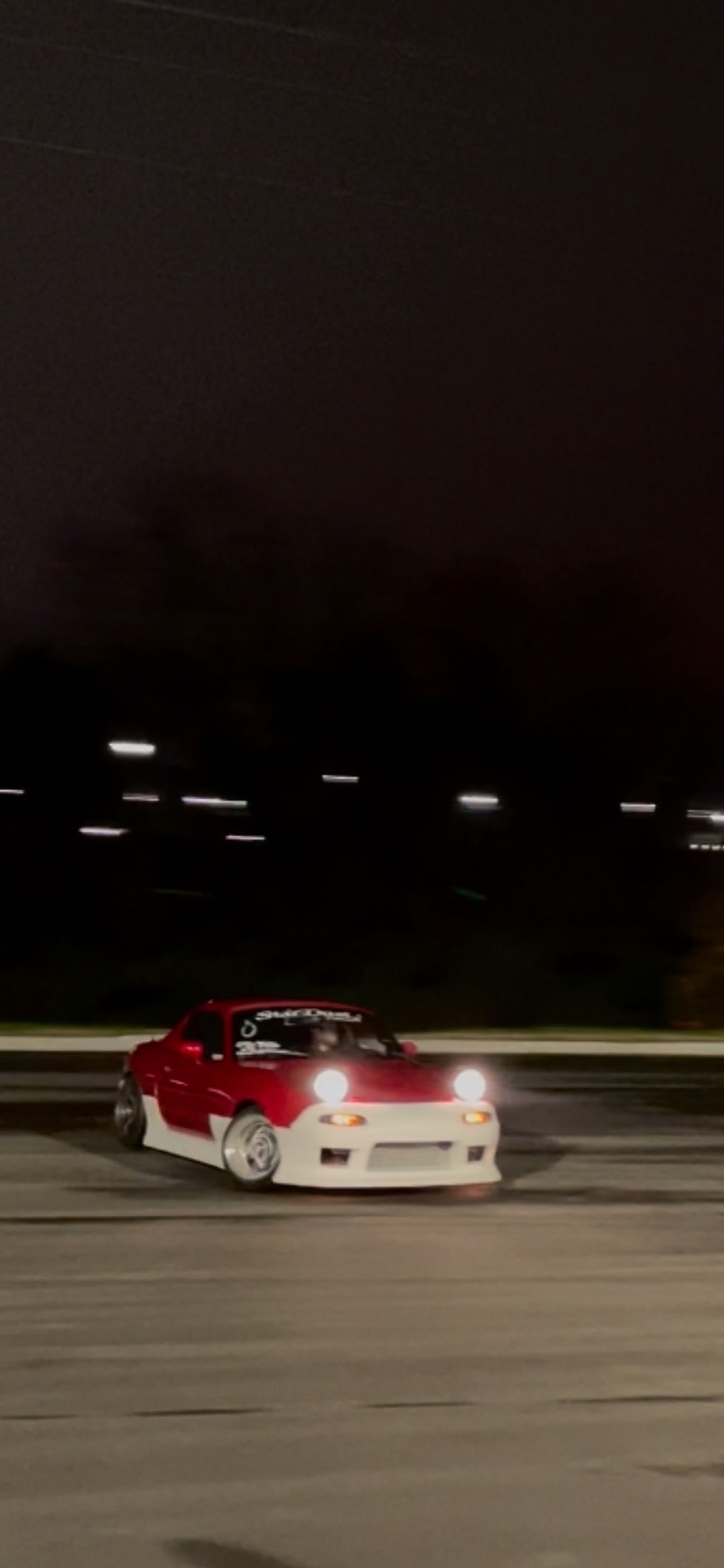

Went out and drove another event, finally being able to drive 100% and enjoy it while being able to focus on getting better as a driver. Took way too long to get here, but was trying my best to keep good style in the car while being able to perform. I went and drove my heart out and had a blast trying new things and getting better.
As you can see, I drove without any aero this day. I had taken it off and it was just sitting at the house for a special reason. After this event, I had cut my season short due to something I'd been wanting to do for a very long time. It was finally time to address the big dent in the quarter, the peeling clear coat, fading paint, and raw gel coated aero. A buddy of mine was going to paint my car and help me out.
