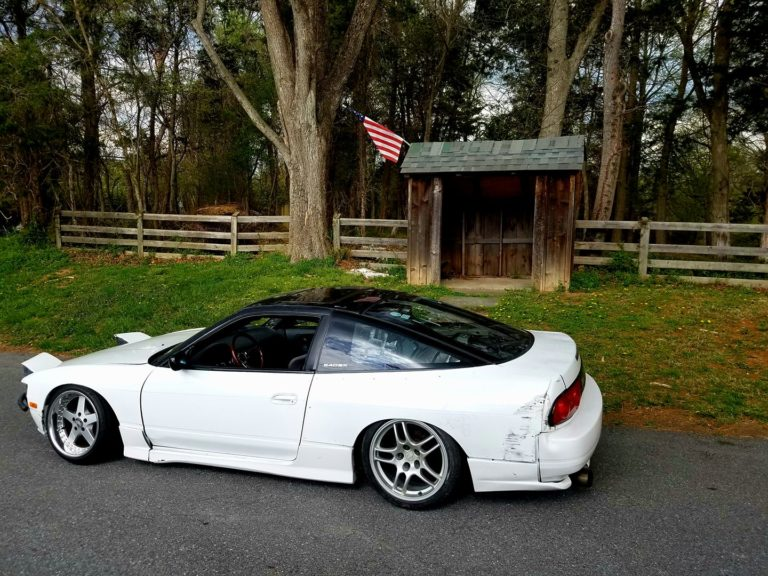

This is essentially the complete story of this car, since first ownership in January 2015 to the present. I started with a bondo-ridden s13 hatch and ended up with a bent-ass tin can spec, body dropped S13, with many elements of minitruck culture embedded within.
For those who have not been exposed to minitruck builds, those trucks generally feature a "body drop" where the frame and cab are modified around the drivetrain, essentially dropping the body over the frame, while keeping the drivetrain raised. The body drop on the hatch involved modifying the unibody and both front and rear subframes to raise the drivetrain and lower the unibody/frame.

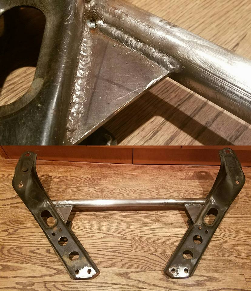

let's make a poor people power brace!

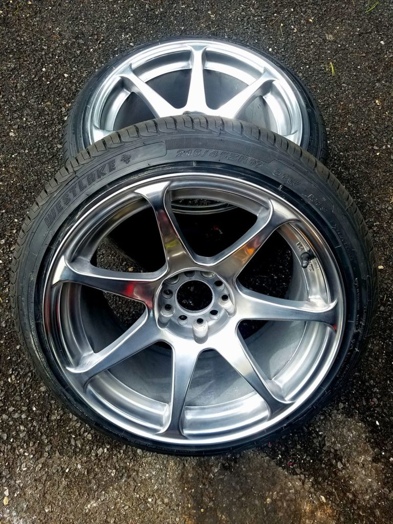

first and last time I hand polish wheels

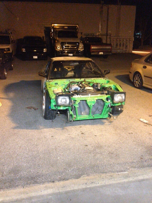

we unfortunately still have the green bay, but now we have camber

sikky green engine bay is definitely peak 2015 energy

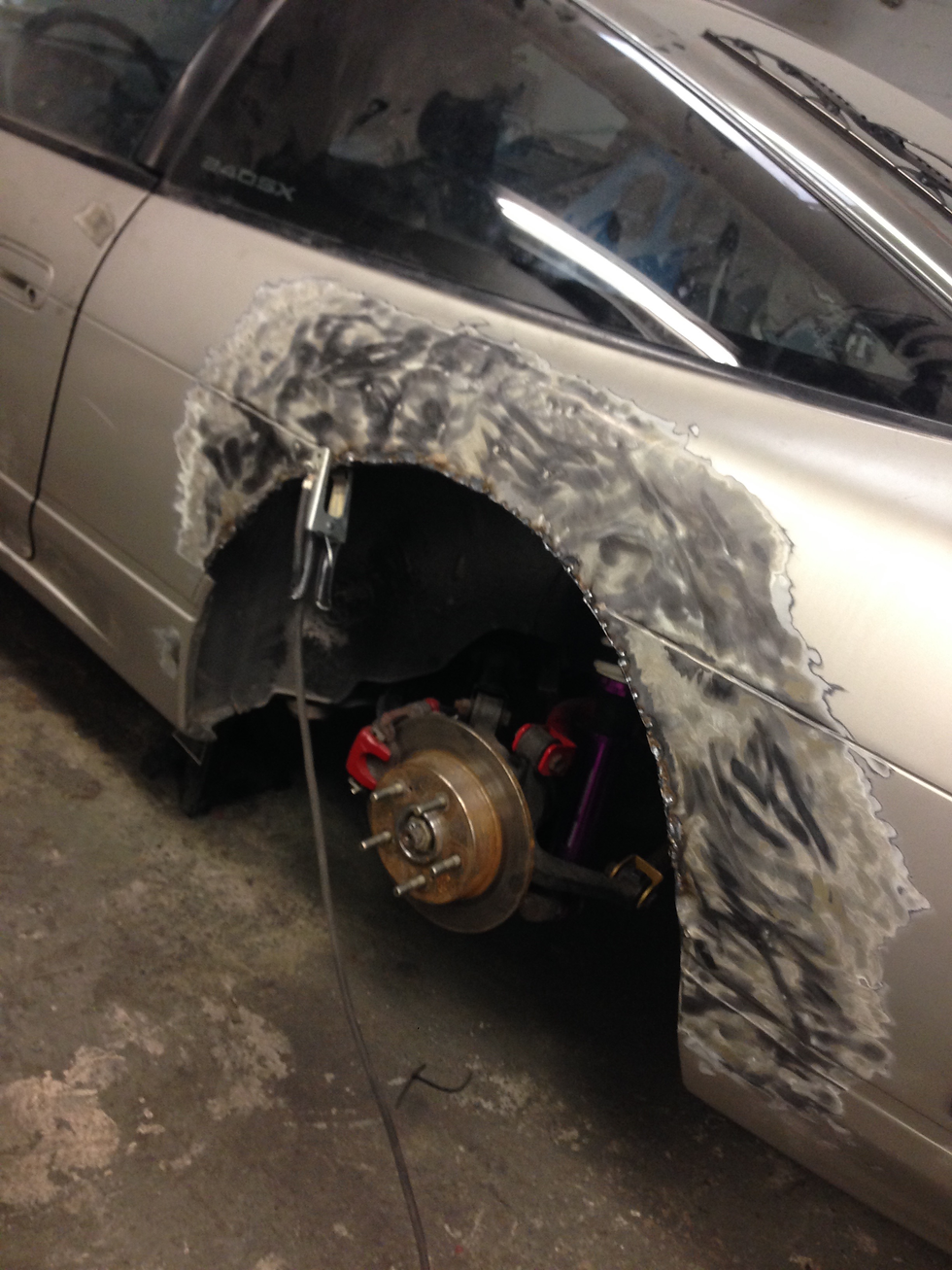

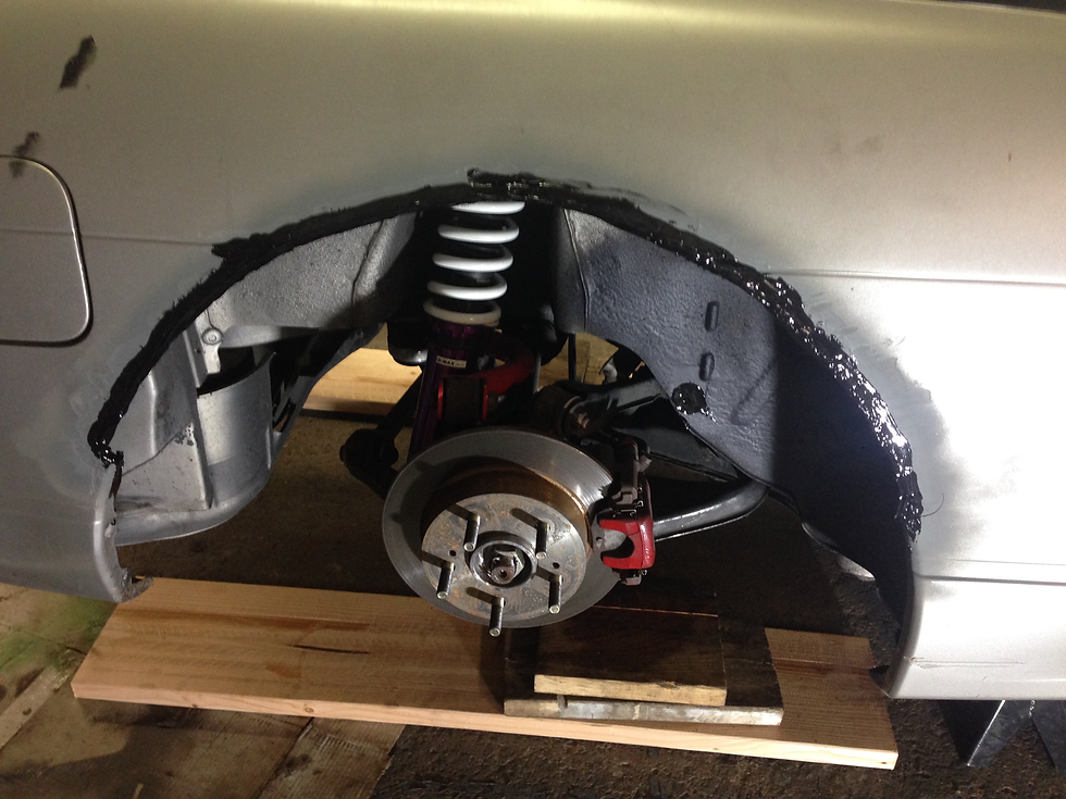

cut the quarters after finding multiple centimeters of body filler hiding a smashed quarter

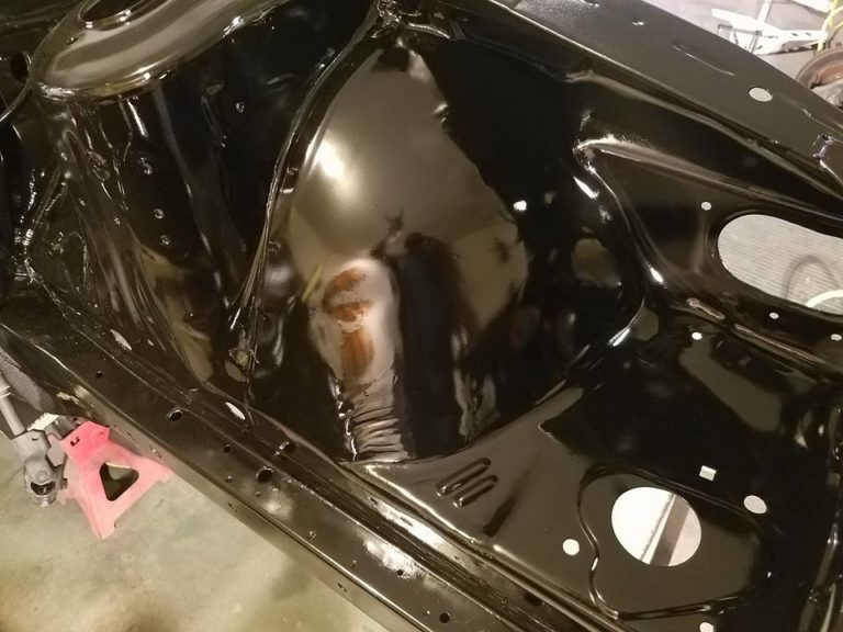

i really hated rust back then and made it my mission to decimate it wherever possible. Now that I know more, I pick my battles
