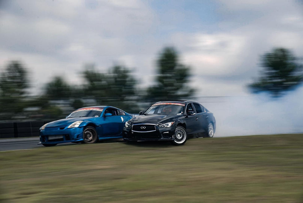

I drove around 20 events in 2020 when I finished the build, including an out of state trip to go drive Midpond and Atlanta Motorsports Park in the same weekend

Fast forward to 2023 and I moved to Orlando and opened my own Infiniti/Nissan specialty shop. I defintitely had to take a step back with driving so much to focus on growing the shop. I only drove 4 events this year but I made each of them count.
I ended up getting a practically free ride to drive pro bro down at etown
The rain sucked, but I did get to do a few dry laps during the week between FD and the Gambler event.
