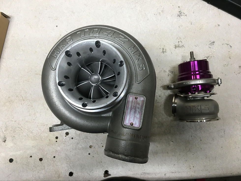

Big 6Boost manifold to hold the TO4Z that I had rebuilt by Boostlabs, and HKS 50mm wastegate.

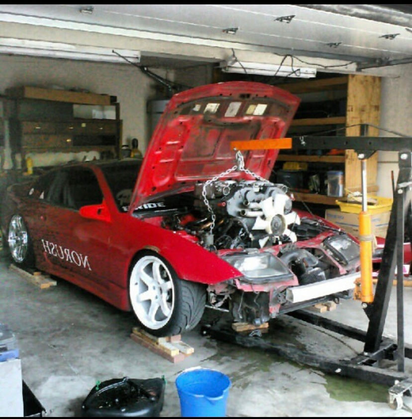

I had enjoyed the car like this for a decent amount of time and acquired some new aero as well as power upgrades for the SR. Pon cams, Power FC, 740cc injectors, turbo etc. The SR starter pack if you will.
Another wheel swap to join the "split 5 spoke gang"
Fitted a URAS drag wing.
One night I decided to introduce my oil pan to the 605 freeway floor.
This gave me the "motivation" to start on the SR swap I had been wanting to do.
