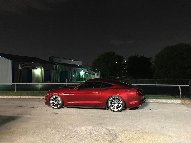

That brings us to more current day. I wanted the car to behave differently in drift, and, without getting too technical, the dual pivot steering was holding it back. So I got an RTR angle kit and finished out the rear arms. It completely changes the front steering geometry and converts it to a single pivot system, which is the Achilles heel to these cars imo.
The front of the car is pretty aggressive now, but god damn. It drives amazing.
I finally got the front suspension settings and ride height figured out. It's probably the best drift car I've ever built, and I think the ecoboost motor is a better/cheaper option over a K swap. If anyone is on the fence about a newer d car, I would highly recommend one.
