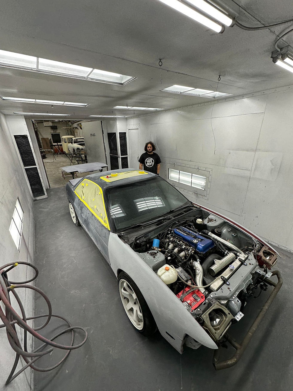

Behold, the current s13.
Car came with only subframes, no wiring, no front, no sunroof, nothing. I was very motivated to begin this reshell and for the first month or two I had done a ton of work bring the old subframes over with updating them by welding in braces and getting some fresh arms..... Then it sat.
In the meantime, I started my own business in the building above my shop and I would only go downstairs onces every 4 months or so to reset a breaker in the electrical. I had become bery burnt out of working on cars and my money situation had changed drastically.
I slowly collected some goodies.
That was until BMI 2023 invites went out and we surprisingly got the invite to come back after the hiatus that covid had created on the event. This is where we invited Matt Brown to join us as a fourth and he began to waste his weekends away helping me build an entire car in less than a month.
Some how it was pulled off and heres a photo dump of the rest of the year.
and heres how the car currently sits. Getting ready for winter upgrades.
